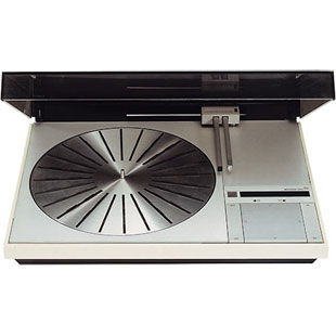

In 1972 with Beogram 4000 Bang & Olufsen used the linear deck principle and developed the world’s first electronically controlled linear, or tangential, tangential record deck. In this pioneering concept, the pick-up moved in a straight line towards the centre of the record parallel with - or tangentially in relation to - the groove. By doing so, the small angular error which would otherwise occur when the pick-up arm moved in an arc on a conventional radial gramophone was removed. Actually the separate arm with its light source and sensor was only used for checking the presence of a record on the platter. This was done by the reflected light being interrupted by the record support ribs of the platter causing a strobed voltage. This strobe would stop the circuit from allowing the pick-up arm from being dropped down onto the platter without a record. It was used to check record sizes as well. The actual drop position was selected and set by a mechanical switch contacts, being allowed when the strobed light source was blocked by the record. Also, when a 7" diameter record was found, the Beogram 4000 would automatically change speed from 33 1/3 rpm to 45 rpm.
The correction for the offset angle of the pick-arm as it followed the record grooves, was controlled from underneath the deck plates, by a metal paddle that had a small slot, attached to the pivot for the tangential pick-up arm. This paddle was sandwiched between a light source above and two photo cells underneath. When it moved inwards it would let some light onto the inner light cell, this causing an error voltage to drive the arm transport motor. Initially the BeoGram 4000s had an outer sensor, where the arm would be driven outwards, in fact it would track a record cut with a spiral groove cut from the centre to the outside. The BeoGram 4002/6000 used more light/sensor circuits with a perspex slide with vertical gratings of various widths to control the arm positioning for auto dropping the pick-up at the lead in edge of the record, and when the arm accelerated at the run out the increased speed would be detected as a higher strobe speed and cause the arm to be lifted and returned to the resting position.
This other, sophisticated mechanical design, the double tone arm, demonstrated the break with the past. By using two arms, it was immediately clear that this was a gramophone which worked in a new and different way. Bang & Olufsen's tangential turntables - Beograms - automatically registered whether the record that you put onto the deck was an LP or a single, and set the speed accordingly - 33 rpm (revolutions per minute) for LPs and 45 rpm for singles.
