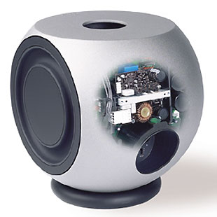

Since subwoofers offer the greatest benefit when powered by their own amplifiers, many subwoofers include the amplifier in the package. Thus an active subwoofer need only be plugged into the wall (the amplifier inside the sub has a power cord that must be plugged in) and attached to a preamplifier with an interconnect cable.

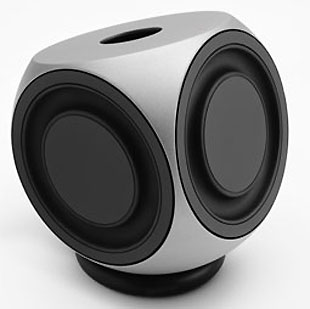

Subwoofers are specially-designed loudspeakers used to reproduce only the lowest booms, bangs and roars in music or movie soundtracks - typically from 80Hz down. They are generally composed of a large speaker or 'driver' (speaker cone, magnet assembly and frame) inside a cabinet. They used to be larger than otherwise is the situation today - Bang & Olufsen has made them much more compact but still enormously effective. Circuitry inside the subwoofer called a 'crossover' limits the incoming audio signals allowing the subwoofer to play only low frequencies.
There are two basic kinds of subwoofers: active and passive. Active subwoofers - such as BeoLab 2 - have a built-in amplifier driving the speaker. Passive subwoofers such as B&O's former Beovox Cona have no built-in power source; they use amplification from your amplifier as do other passive speakers. It's easy to tell the difference: look for a power lead!

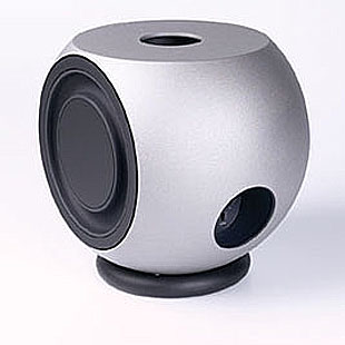

There are a number of different kinds of subwoofer enclosures. The two most frequently used are 'sealed cabinet' and 'vented cabinet' designs. Most subwoofers have an outward facing speaker (or speakers). Sealed box enclosures will have no other opening. Vented boxes will have a hole in the cabinet, a few centimetres in radius which allows to air escape from the cabinet.
Each cabinet design has advantages and disadvantages
A sealed box has more accurate bass response and will handle super-low frequencies better. The disadvantage is that they require much more power, a larger cabinet, and a larger speaker/magnet assembly than a vented subwoofer. This means that in effect they cost more
A vented enclosure requires much less energy to create powerful bass response. This means smaller amplifiers, smaller cabinets and smaller speaker assemblies. That makes them less expensive. The down side of a vented subwoofer is that it's less accurate. It is louder but less refined - particularly in the lowest frequencies
A 'band-pass' is a third kind of subwoofer cabinet, and is essentially a sealed cabinet subwoofer inside a vented box. This design requires very little power and is used for small, passive subwoofers the kind frequently used with compact multimedia speaker systems. These are not high performance home cinema or audio systems.
