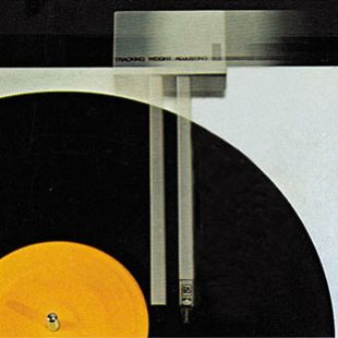

If you placed a grooveless record on your turntable, the stylus would be automatically pulled towards the centre of the record. This phenomenon is called skating. It is unwanted because the "pull" results in greater exertion of stylus pressure on the inner groove wall. This skating effect must be reduced if high-fidelity standards are to be achieved. On Bang & Olufsen's record-players the anti-skating device was automatic. It was not visible because it was an internally integrated part of the arm rather than an externally fitted device.
Tangential arm
When cutting a record, the cutter-head moves in a straight line towards the centre of the record. It is only natural to use the same principle in play-back. However, manufacturers have declined because of the difficulties inherent in mechanical methods and, of course the price involved. Until the time that Beogram 4000 was introduced in 1974, all had been satisfied to let the arm trace an arc across the record's radius. Bang & Olufsen's tangential arm solved this problem. A servomotor moved the entire pick-up arm across the record in a straight line towards the centre. Skating was eliminated as there was no "pull" towards the centre of the record. An anti-skating device was unnecessary.
