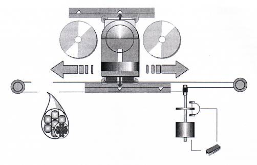

The primary principle distinguishing BeoSound 9000 is playback of CDs, visibly
placed in a linear fashion. Instead of transporting the CD to the laser pick-up,
the laser finds its way to the CD, speedily and elegantly. These principles
provide a new way of using - and living with - compact discs (see above
picture).

Besides expressing a brilliant idea, BeoSound 9000 is a remarkable technological
achievement. One of the most prominent features, the automatic positioning of
CDs, is a unique compound of a simple, yet powerful idea, combined with advanced
digital technology.
With auto-positioning, BeoSound 9000 is capable of detecting and memorising a specific angular position for CDs. After playback, a CD returns to a position chosen by the user; most likely a position where the textual information printed on the CD is readable.
A small piece of information on the CD, the so-called P-bit, is used as the point of reference for the angular positioning. Using the location of this P-bit information, present on virtually all audio CDs, software-controlled tachometers enable a very precise positioning of discs after playback. Automatic positioning of CDs by use of the P-bit information is a Bang & Olufsen copyright.
