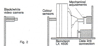

Figure 2 shows the adjustment setup. Two sets of colour sensors on a rail are automatically brought to rest on the surface of the picture tube, measure the light intensity in the two fields accurately. Each sensor contains three photo cells with optical filters for red, green and blue, respectively. The filter characteristics allow only one colour to pass, which means that the intensity of the light can be measured as an electrical voltage generated by the light sensitive photo cell. The fields are now adjusted according to the voltage measured by the photo cells, until the delicate balance between the three guns is correct.

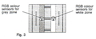

Figure 3 shows the sensors in relation to the
test picture. The levels measured by the sensors are digitised by the A/D
converters and fed to the computer, where they are compared to the levels in the
reference test picture for subsequent correction. The adjustment computer is
automatically connected to the TV in the setup, via the standard Datalink socket
and sends any required correction signal to the microcomputer in the TV set. The
RGB video amplifiers are then adjusted electronically by the microcomputer until
the two fields in the test picture show the correct light intensities.

converge. Returning to figure 2, we also note a camera placed at a certain
distance from the screen. The camera monitors the thin white lines in the test
picture and compares them to the reference test picture. If the picture is not
correctly aligned, corrections are relayed to the TV microcomputer to adjust the
circuits that control the deflection currencies.

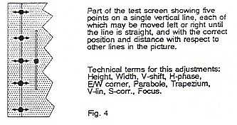

The geometry adjustment starts with a completely white screen picture to align
the camera to the particular type of TV being adjusted, be it LX or MX and with
different screen sizes. The adjustment setup also registers and takes into
account the small tolerances in the placement of the TV on the assembly line.
Apart from the details of the geometry adjustments shown in figure 4, the setup
also adjusts the focus. The camera monitors one of the white lines against a
black background and digitises the measurements. The digital levels correspond
to a statistical calculation around an average value and can be compared to a
reference. The measured levels are computed, compared and corrected, until they
correspond to the reference values, which gives optimal focus.
