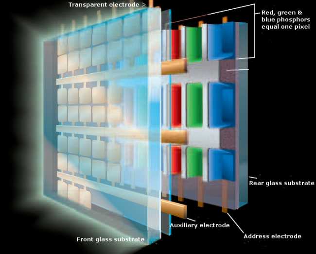

How It Works
Plasma TV works by suspending an inert gas such as neon or xenon in between two
glass plates that are meshed together. Between the glass panels there are
generally over 1 million pixel cells capable of producing 16.7 million colours.
A series of electrodes located above and below the cells (the top electrode
layer is transparent) jolt them with varying amounts of voltage. This excites
the gas in the cells, which in turn stimulates the phosphors to produce coloured
light that we can see. Plasma is created (hence the name) and causes
ultra-violet light to be created. We cannot see UV light, but this light is used
to illuminate phosphors built into the glass, creating visible light. Each pixel
in a plasma display consists of three gas-filled sub-pixels (cells) coated with
red, green or blue phosphors.

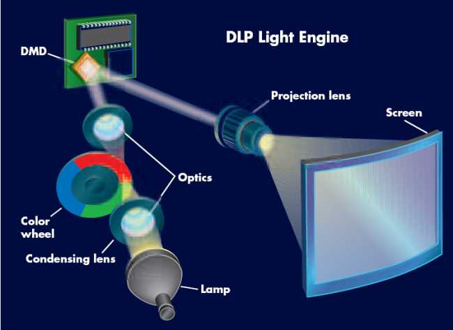

How It Works
At the heart of every DLP™ projection system is an optical semiconductor known
as the Digital Micromirror Device (DMD) which was invented by Texas Instruments
in 1987. The DMD chip is probably the world's most sophisticated light switch.
It contains a rectangular array of up to 1.3 million hinge-mounted microscopic
mirrors; each of these micromirrors measures less than one-fifth the width of a
human hair, and corresponds to one pixel in a projected image. DLP
sets fall mainly into two camps:
single-chip front- and rear-projection TVs filter white light from the lamp through a colour wheel to produce colour
three-chip front projectors - which are generally much more expensive - dedicate one chip each to the red, green and blue primary colours
If the three tubes used in a CRT projector to
beam an image onto the screen aren't kept perfectly aligned, the edges of lines
will appear discoloured. But since DLP images derive from a chip whose alignment
characteristics don't 'age' there's no need to tweak the picture periodically.

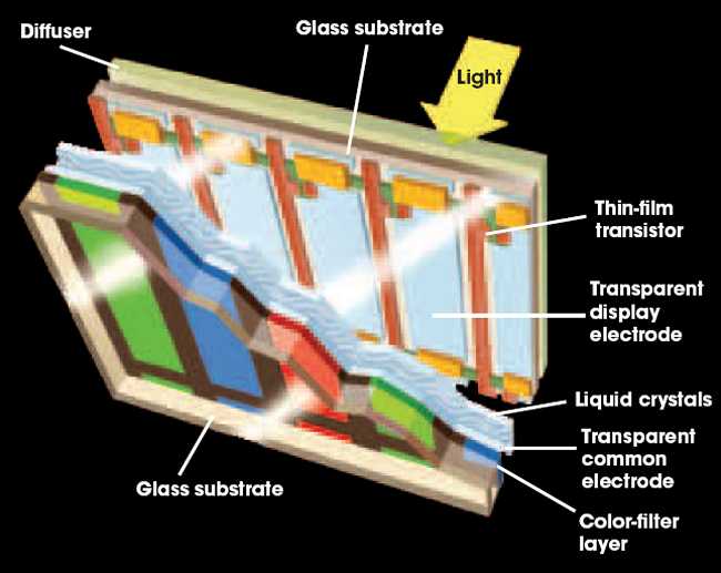

Whether spread across a flat-panel screen or placed in the heart of a projector,
all LCDs are pretty much the same. A matrix of thin-film transistors (TFTs)
supplies voltage to liquid crystal-filled cells sandwiched between two sheets of
glass. As with plasma panels, a trio of red, green, and blue cells make up one
pixel. When hit with an electrical charge, the crystals 'untwist' to an exact
degree to filter light generated by a lamp behind the screen (for flat-panel
TVs) or one shining through a small LCD chip (for projection TVs).

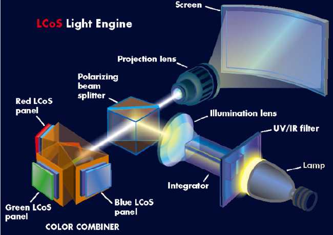

LCoS
The least-familiar player at the fixed-pixel poker table, LCoS (Liquid Crystal
on Silicon) owes most of its technological heritage to LCD. But it outperforms
LCD in many respects because it allows for smaller-size pixels that provide
higher resolution and almost eliminate the screen-door effect. LCoS has
tremendous potential for home cinema, but at the moment it's only available in a
handful of products.
How It Works
At the heart of a LCoS projector or rear projection television are between one
and three LCOS Semiconductors. The LCOS micro-displays use a twisted Nematic
Liquid Crystal. When an electric field is applied to the crystal the amount of
twist varies. Using this principle a beam of light is passed through a polariser
to make the light waves travel in a single direction. The Twisted Nematic Liquid
Crystal causes direction of the polarised light to change. This light is then
reflected off the LCOS reflective coating and providing it is in the correct
direction it then passes through a second polariser (called the 'analyser').
