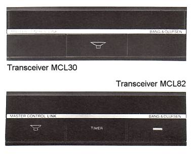

Outline of the two Master Control Link Systems:
The two Link systems consisted of two parts:
1. Transceiver (infra-red transmitter-receiver with some direct control buttons)
Dimensions 130 x 39 x 22mm |
2. Relay box (containing control electronics and connections)
Dimensions: 160 x 110 x 35mm |

Operation from Transceiver
MCL82, Type 2041
If no Master Control Panel or Terminal was at hand in the Link room, operation may be executed, to a limited extent, from the Transceiver box itself. Below are the functions for speaker control and stand-by:
