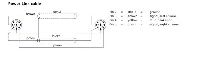

(Note: On BeoLab3 there is a blue wire
(pin 7) in addition to the wires shown here on the PowerLink diagram. This
appears to be a voltage reference for the speakers, and with a single three core
wire + screen feeding both speakers, this needs to be connected to the screen.
Failure to connect this pin does not have too much of an effect on the system
-UNLESS- you connect up something like a PC2 which ties the stereo to Earth
potential through the MasterLink cable, and without the "blue reference" the
speaker inputs can float to around 100V above Earth and cause interference
between the speakers and the 3000, manifesting as a quiet buzzing noise in the
Lab3s. (I rather suspect there was actually an impact on sound quality from no
Blue connection but cannot measure it) - Stephen Lewis)

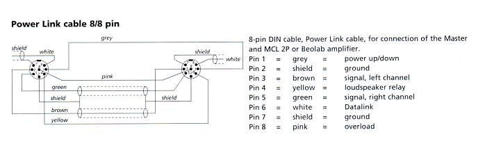

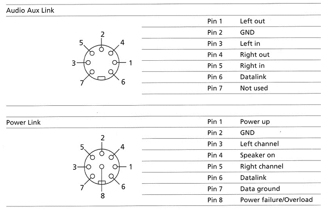

Audio Aux Link / PowerLink connections:
