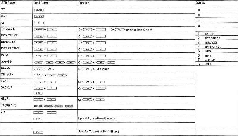

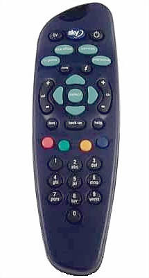

Using your Beo4 remote control with Sky Digital:
Details above courtesy of Andrew Keller: the information above relates to the Sky Digital STB option (at least) in Australia based on the STB-C version on a controller model: 1416700 |
