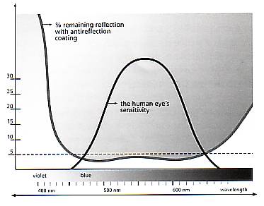

Eliminating wavelengths
Graph showing the effect of the three-layer coating to different colours/ wavelengths. The
layers are designed to match the colours most sensitive to the human eye. The
majority of visible colours are reduced to a reflection below 5%.
| The amount of light reflected by the coated surface is reduced to 0,6%,
compared to the 5,2% for an uncoated glass surface. Reducing reflections by a factor of 10 drastically reduce the annoyance caused by reflected lamps and windows. However, the most important effect is the improved contrast, as the light from the picture tube does not have to compete with the ambient light in the room. The anti-reflection coating combined with the contrast screen is especially
beneficial when television is viewed by daylight or in illuminated surroundings.
