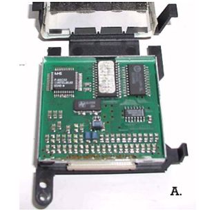

You are actually replacing PCB 3 which is the Microprocessor and memory all in one module.

A - The Microprocessor module that will be replaced to upgrade the software version.

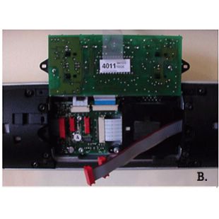

B - The unit front removed showing the Microprocessor on the right before removal.

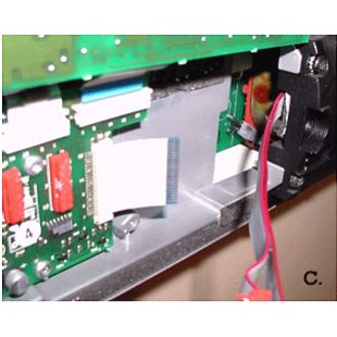

C - The Microprocessor removed and awaiting the new one to be fitted.
