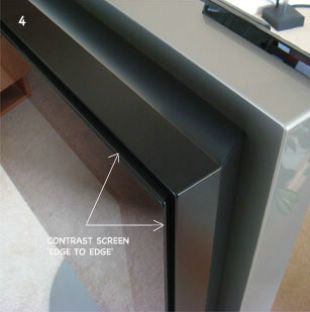

In Photo's 3 and 4 you can clearly see the difference between the two. The 'Real Flat' has a contrast screen that covers the tube from 'edge to edge' and has the appearance of one solid single sheet of glass, with the Bang & Olufsen logo displayed behind the glass contrast screen. This flatness gave rise to the term 'Real Flat' as this is exactly what the tube is.
