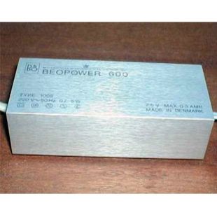

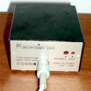

Beopower 600/1000
Manufactured: 1971 - unknown
Colours:
Beopower 600 was a mains adaptor which was able to run Bang & Olufsen products such as Beolit 400 and Beolit 600 which required just 7,5V.
This saved the products' batteries and therefore lessened running costs. Beolit 500 and 700 had built-in power units so Beopower was not required. Beopower 1000 was designed specifically for Beolit 1000.
Beopower 600/1000 Product Specifications
Beopower 600 Specifications
Dimensions W x H x D 49 x 36,5 x 11 mm
Weight 385g
Power supply: voltage 220 V AC, constant connection to mains, type 8901005 240 V AC, constant connection to mains, type 8901006
Power consumption 0,7 - 5 watts
Output voltage 7,5 volts DC, stabilised
Output current Max 0,5 amps, short-circuit proof
Internal resistance < 1 ohm
Connector socket DIN 45 323
Semiconductors
Transistors 2
Diodes 5
Beopower 1000 Specifications
Dimensions W x H x D 98 x 60 x 108 cm
Weight Approx. 850g
Power supply : voltage 220 V AC, constant connection to mains, type 8901005 240 V AC, constant connection to mains, type 8901006
Power consumption Max 25 watts
Output voltage switchable between 6 - 7,5 - 9 and 12 volts DC
Output current Max 10 watts at 7,5 vols. Short-circuit proof.
Semiconductors
Transistors 3
Note that the power supply incorporated an electronic protection circuit which automatically turned off the output voltage in case of short circuits and overloads
