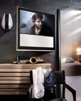

Room for a View
The third set in the ever expanding BeoVision 10 range, this set was designed primarily as a link room set. It shared the thin profile and design of the other sets in the series but lacked the surround sound module of the bigger sets. It was possible to attach both a sub-woofer and two front speakers though these reverted to the system seen many years earlier in the LX and MX sets of utilising a centre balance system.
In common with the BV10-40, an LED edge backlight system was used though the screen itself was a 100Hz device.
Sound was catered for by two way active speakers for each channel though the innovative bass woofer box seen on the 40" and 46" models was no longer present. Interestingly a similar frequency response of 85-20-000Hz was claimed.
A DVB module was an option and the same facilities for switching off the analogue tuner were present on this model as its larger brother.
Connections were comprehensive with 3 HDMI sockets being standard with the third able to be attached to an expander.
Mounting Options
Bang & Olufsen stands available at launch included Motor Table Stand, Motor Floor Stand and a simple Wall Bracket using the hinged device seen previously to position the rear of the TV close to the wall.
