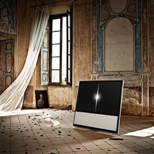

Beovision 11 - 40" LCD Television
Manufactured: 2012 - present
Designer: David Lewis
Colours: Frame/Cabinet: Black/black, silver/black, black/wh
B&O's first smart TV, being based on the design of the successful Beovision 10. Major changes include the 3D facility and an upgraded sound performance. 6 HDMI ports are available, one being on the accessory panel, and the TV can be controlled with either the Beo4 or 6 or via an iPad or Android tablet.
