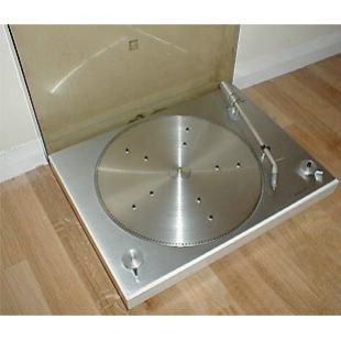

From an audio point of view, this was an advance in some ways - isolation from vibration was slightly better though still not up to the later decks. The peg support for the records was however not so clever as the excellent mat of the 1000 and 1800 offered far better cushioning. It did however look wonderful. Close inspection of the studs reveal that the inner studs are slightly shorter than the outer ones. They do remove for cleaning so do make sure you put them in the right places!!
