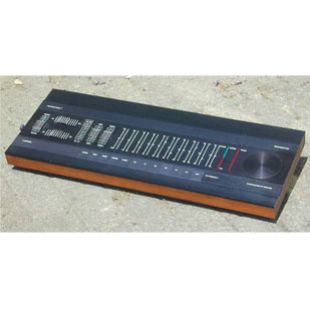

Beomaster 3400 Type 2802 was a 4-channel receiver whose out put was stated as 4 x 20W or 2 x 30W, depending on how it was configured.
This receiver was a development of the Beomaster 2000 but as well as being quadraphonic, was FM only. The tuning scale was extremely unusual being a series of vertical scales rather than a single horizontal one. Despite the huge length thus provided, it still only read up to 104!
It was designed to be partnered by the Beogram 3400 which could provide the correct 4 channel input as well as the stereo cassette player, the Beocord 2200. S45 or P45 speakers made up the rest of the system.
