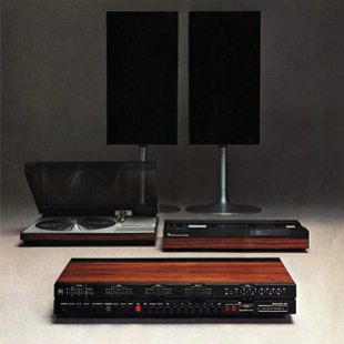

BeoMaster 4000 Tuner/Amplifier
Manufactured: 1972 - 1977
Designer: Jacob Jensen
Colours: Rosewood, Teak
The amplifier section of this receiver had outstanding technical data: harmonic distortion was less than 0.1% at maximum power output and 0.06% at 50 mW. Frequency range was 20-30.000 Hz and effective bandwidth 10-35.000 Hz.
Frequency correction facilities were the LOW filter which reduced rumble on records (12 dB per octave at 80 Hz) and the HI filter which damped hiss (12 dB per octave at 4000 Hz). With the LOUDNESS control you could switch between objective and subjective linear reproductions. Beomaster 4000 had facilities for stereo and ambio reproduction. There were sockets for a record player and two tape-recorders, one allowing A\B monitoring. The headphone connection was placed on the receiver's front. All inputs could be adjusted to give equal volume from all programme sources. The FM section had six pre-set stations. A light indicator assisted accurate tuning and an illuminated meter indicated the strength of a station. Field effect transistors, ceramic filters and integrated circuits were used.
When combined with a built-in record deck, the music centre was known as Beocenter 3500.
