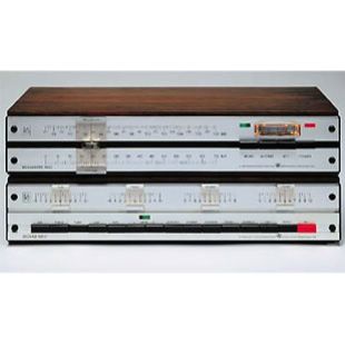

BeoLab 5000: the European High-Fidelity format
“Design is a language which is understood by everyone…” as designer Jacob Jensen expressed it and demonstrated it in practice.
" A silicon-transistor high-fidelity amplifier with less than 0.6% distortion at all frequencies and at all volume levels up to 2 x 60 watts of power output. Its signal-to-noise ratio is better than 90dB (linear measurement). It has calibrated graphic controls and is extremely versatile, due to an unusual number of input and output facilities.
The Beolab 5000 is an amplifier that introduces no hiss or hum and reproduces all frequencies of the tonal range exactly as received. It has enormous power, permitting reproduction of even the loudest passages without distortion. Moreover, operation is logical and straightforward; varying or poor record quality can be compensated by means of efficient filters which remove the particular tonal range in which flaws are present; there is provision for connecting several speakers, including centre speaker, as well as provision for channelwise control of programme material. A special feature is a test control to facilitate adjustment of balance between channels. The use of silicon transistors ensures very low noise level, high temperature stability, and a very wide tonal range." - taken from the 1967

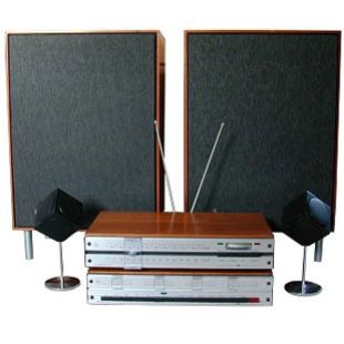

Bang & Olufsen's Beomaster 5000 FM tuner, BeoLab 5000 amplifier and Beovox 2500 Cube loudspeakers were the first product series designed by Jacob Jensen in 1967.
The traditional style for tuning knobs was replaced by an exact measuring instrument akin to the slide rule which was considered an innovation in changing the future of radios and amplifiers. The interface, in its precision and simplicity, proved to give the user optimal functionality. This solution had never been seen before and laid the foundation for the future form language of B&O. On this basis, Jacob Jensen was asked to design B&O´s audio programme. Beomaster 5000 was an FM tuner, with elimination of static between stations and a built in 'data base' which automatically tuned in on stereo broadcasts.
Partner to BeoLab 5000 was Beomaster 5000, an amplifier with the same slide rule interface.

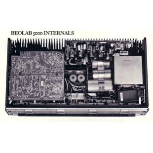

Feel the quality with the Beolab 5000! Note - it weighs over 10 kg for a fairly small box. The beomaster 3000 which effectively replaced it and included the tuner in a bigger box was only 8 kg.
