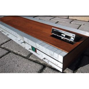

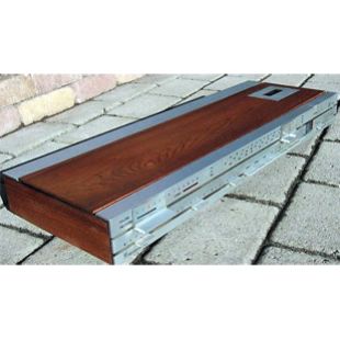

Beocenter 1400 - "Each unto his own taste" - especially with music.
The amplifier section of Beocenter 1400 offered qualities which were unusual for a combination product in this price-range. Frequency range was 20-30.000 Hz, with harmonic distortion of less than 0.5 % at maximum output. Power output was 2 x 20 watts RMS or 80 watts total music. The technical data of the FM section, like those of the amplifier fulfilled the DIN 45500 high-fidelity norms by a wide margin. A wide frequency range was obtained both on mono and stereo reception. The balanced light indicator was a simple but effective aid to accurate tuning. The automatic frequency control (AFC) facility allowed precision tuning.
Receiving distant stations was no problem on Beocenter 1400 owing to the receiver's high sensitivity (better than 1.8 uV IEC). The compact cassette section had its own operating facilities: ON/OFF switch and piano key push buttons for recording and play-back functions. You could switch between chromium dioxide and normal tapes. Recording level was controlled by a handy slider on a numerical scale and light indicators: Red or green light showed overloading or satisfactory recording level. Tape-heads were of super permalloy, an extremely durable material which ensures a long useful lifetime. Wow and flutter was less than ±0.28% (JIS norm).
Signal-to-noise ratio was better than 50 dB with chromium dioxide tapes. Bang & Olufsen placed emphasis on good station separation in the AM section (long and medium waves) without sacrificing sound quality. A slider control aided radio tuning. Beocenter 1400 had sockets for a record player, headphones and loudspeakers. An extra tape or cassette-recorder could also be connected. Beocenter 1400 utilised the (then) latest electronic components: Darlington transistors, field effect transistors, integrated circuits and ceramic filters.
When combined with Beovox 1702 loudspeakers and/or Beogram 1203, the system was known as Beosystem 1400.
