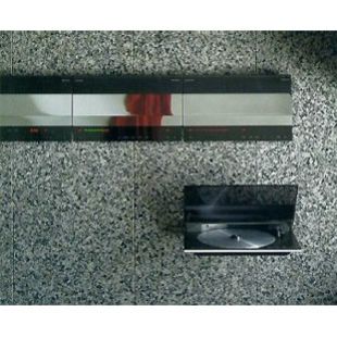

BeoSystem 4500
Manufactured: 1989 - 1994
Designer: Jacob Jensen & David Lewis
Colours: white with polished aluminium
BeoSystem 4500 - A touch of magic
The simplicity of the exterior was matched by simplicity of operation. A light touch directly on the illuminated display gave immediate access to the system. Or, you could operate BeoSystem 4500 with the BeoLink 1000 terminal, summoning forth magical sounds from the comfort of your favourite chair.
BeoMaster 4500
The BeoMaster 4500 receiver received both FM and AM - and was your communication link to the other sound sources in the system. Its operation was simplicity itself with an illuminated menu presenting all the options available. 20 radio stations could be pre-set providing you with instant access together with automatic fine tuning.
BeoCord 4500
The BeoCord 4500 cassette recorder housed exciting details and distinguished technology. Like Auto Reverse, so you did not need to turn over the tape. Automatic registration of the type of tape, and Bang & Olufsen's patented HX-PRO recording system that provided optimal sound reproduction.
BeoGram CD 4500
The sound reproduction achieved by Bang & Olufsen's CD 4500 CD player was truly outstanding. It played both 12cm and 8cm compact discs and had an ingenious 'step' function which allowed you to go straight to a chose track selected from anywhere on the disc.
BeoGram 4500
In building the BeoGram 4500 turntable, Bang & Olufsen applied all its classic principles to ensure reproduction as close to perfection as possible. The electronically-controlled tangential arm played each record exactly as it was recorded. And there were built-in systems that helped prevent vibrations reaching the cartridge or turntable. BeoGram 4500 employed a finer, ultra-light MMC2 cartridge that combined distinguished sound reproduction with maximum protection for your records.
Designed by Jacob Jensen, Beosystem 4500 in 1989 received the Japanese Good Design Award for its elegant design
