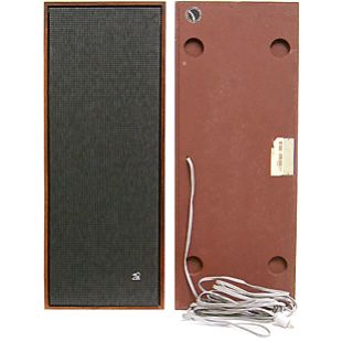

BeoVox 1000 Passive Loudspeaker
Manufactured: 1966 - 1970
Designer: Jacob Jensen
Colours: Rosewood, Teak
"B&O loudspeakers will meet very exacting conditions as their specifications exceed international hi-fi standards. All B&O speakers are of the pressure-chamber type with an impedance of 4 ohms. They are available in matched pairs only in a choice of teak or Brazilian rosewood finish"
- taken from the 1967 - 1968 Bang & Olufsen product catalogue
_______________________
BeoVox 1000 Passive Loudspeaker Product Specifications
Dimensions W x H x D 470 x 190 x 240mm
Weight 5 kg
Power handling capacity 10 watts continuous (DIN 45573)
15 watts peak power
Resonance, low-frequency unit 50-55 c/s
Frequency response (DIN 45570) 60-19000 c/s
Impedance 4 ohms
Angle of coverage 90°
Volume 14,5 litre
Speaker units: Low-frequency unit and high-frequency unit. Crossover frequency: 5000Hz. Frequency response (DIN 45570): 55 - 18000 Hz. Power rating: 10W (RMS), 15W (Music). Volume: 14.5 litres
Dimensions: 190mm high, 470mm wide, 240mm deep
Designed by Jacob Jensen, Beovox 1000 won the iF Award in 1967
