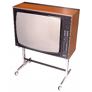

BeoVision 3400
Manufactured: 1971 - 1974
Colours: Rosewood,Teak, White
Beovision 3400 Type numbers: 3230, 3231, 3232, 3235 was a 66cm television fitted with sliding tambour doors to protect the screen.
Beovision 3400SJ was introduced to the UK market in 1971. It was sold for three years when it was superceded by Beovision 5000.
