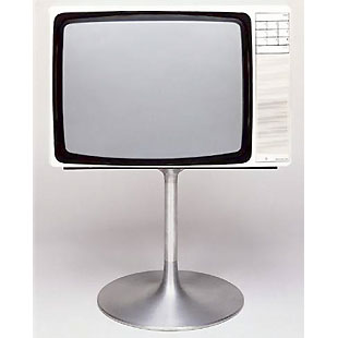

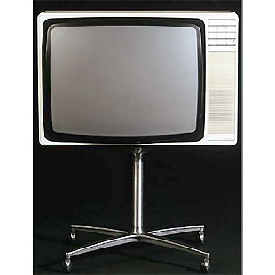

Beovision 3500 type number: 3907 was a 56cm colour television designed by David Lewis and Henning Moldenhawer. It could be placed on two types of stand - the trumpet stand (shown above) and the cross foot stand.
By 1975, colour television had become commonplace in homes throughout Western Europe. And a lot of those homes were furnished in white - the 'in' colour of the 1970s. Television, as a lot of home furnishings, followed this trend and Beovision 3500, with its trumpet base and cross-base on wheels, reflected what was happening in the world of interior design. The cabinet was made of moulded plastic and its appearance was markedly different from most other televisions of the era.
