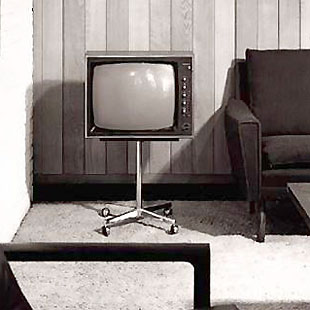

BeoVision 400
Manufactured: 1965 - 1966
Designer: David Lewis and Henning Moldenhawer
Colours:
Beovision 400 was a transportable television designed in 1965 by the young David Lewis and Henning Moldenhawer while working under the direction of Jacob Jensen.
