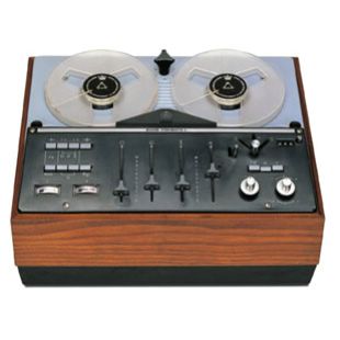

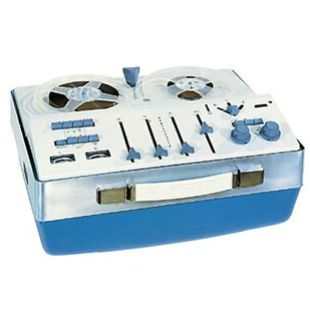

Beocord Stereomaster was a reel-to-reel tape recorder which was novel for its time in that it had an Automatic Stop Function for if the tape should break during play. There were two variations - Type T was designed to be transportable; Type K was designed for a more static position.
The tape recorder is ready just to plug in as the connections have been built in the bottom of the furniture cabinet.
The new B&O Beocord Stereomaster Tape Recorder is the ideal recorder for the discriminating tape amateur. For the first time in the world you can have an amateur tape recorder with a built-in mixing panel for simultaneous mixing of three input signals.
Here, for the first time, is an all-transistor Hi-Fi tape recorder comprehensive professional specifications, including:
(1) Synchronous motor of the Pabst type
(2) Separate recording and playback heads
(3) Recording quality may be checked at any time, either before recording (at the recording amplifier output) or after (at the tape monitoring amplifier output)
(4) Equipped with two V. U. meters.
(5) Three dual-input channels with slide-potentiometer adjustment.
(6) Professional standards for speed, wow and flutter."
