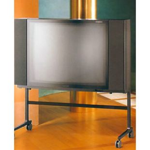

BeoVision LE 6000
Manufactured: 1992 - 1995
Colours:
Beovision LE 6000 and Beovision ME 6000 housed all the basic qualities that were the hallmarks of a Bang & Olufsen TV. However, they lacked some of the more specialised B&O facilities such as Beolink and AV integration.
Both Beovision LE 6000 and ME 6000 were equipped with Black Line picture tubes, which made the picture sharper. A toned-contrast screen in front of the tube enhanced the contrast level, making the picture more pleasant to watch. And Bang & Olufsen's Colour Transient Improvement improved the sharpness of colour transitions, which eliminated irritating shadows. The powerful loudspeakers - under the screen on Beovision ME 6000 and to the side of the screen on Beovision LE 6000 - were based on the full-tone bass reflex loudspeaker system that gives sound power and fullness. Both were equipped with A2 and NICAM stereo systems.
They had Teletext that could be operated with the help of the remote control. The same remote control operated all video functions, if you connected a Bang & Olufsen video recorder.
Beovision LE6000 came first in 'oil' black, with both the ME/LE 6000 models available in the latter stages of production in 'rubber' black. Neither model could be connected to a motorised stand.
BeoVision LE 6000 Product Specifications
Types:
5303 ( 1992 - March 1994)
5307 ( 1992 - March 1995)
Picture tube: (visual picture) Black Link 70cm (66cm)
Flat square, in-line 110°
Contrast screen: glass
On-screen display
Operations: Beolink 1000, one-way
Finish: back
Tuner range type 5307: EU 46 - 855 MHz: VHF, S, Hyper, UHF
Tuner range type 5303: GB 470 - 855 MHz: UHF
No of TV programmes: 60
Teletext: TOP, FLOF, 5 alphabet
Type 5307 EU:
Stereo decoder NICAM EU + A2
Type 5303 GB: Stereo decoder NICAM GB
Speaker units 2 x 10 cm full range
Long-term max. output power 2 x 20 W
Power supply: 220 - 240 V
Power consumption Typical 120 W, min 15 W
Dimensions W x H x D: 86 x 52 x 46 cm
Weight: 46 kg
Connections: AV1 & AV 2, S-VHS, Audio out, Headphones
