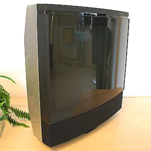

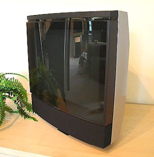

BeoVision MX 4200
Manufactured: 2003 - 2006
Designer: David Lewis
Colours: Light blue, grey dark grey and black
The Final Chapter
The last word in a fine story, the MX4200 looked modern at its introduction despite being modelled on an 18 year old design. A testament to the vision of David Lewis.
Beovision MX4200 is a 52cm 4:3 television set, and is based on an updated chassis of Beovision MX4000/4002. It has the same design line as the previous MX model range but includes the following improvements:
Improved picture quality
16:9 format handling
Set-Top Box Controller as standard
Camcorder connection
Theft protection
MasterLink module (optional)
RF Modulator (optional)

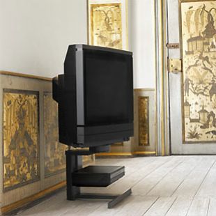

Stands:
Type:
Height, incl. TV
Floor stand
4088
102 cm
Wall bracket
Motorised Wall bracket
4114
4089
Shelf V8000+DVD1
4134
