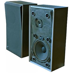

Beovox X25, X35 and X40 speakers were, at the time of their introduction, newly-developed speakers. The two speakers were very similar in appearance.
Beovox X35 featured a 20cm bass unit and 2.5cm tweeter. Power handling capacity was 30 watts RMS. The cabinets measure 48cm high, 26cm wide and 18 cm deep. They had a built-in wall-mounting facility and were finished in a dark grey metallic effect.
