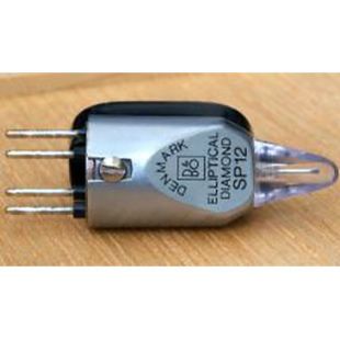

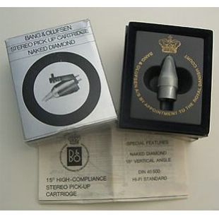

SP 12A Fitted to Beogram 3000, it had an elliptical naked diamond stylus with radii of 5x17u.
The highly polished stylus was designed to track the most difficult record grooves of stereo and SQ matrix records. Distortion in difficult treble passages was at an absolute minimum. Frequency range, stylus pressure and compliance, as the SP 10A. Replacement stylus: type 8905430

This was the upgrade cartridge. As the bodies were the same, only the outer casing with stylus had to be changed.
