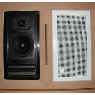

Beovox IWS2000 speakers were designed for rooms where people wanted sound but no visible loudspeakers.
These speakers were built into the wall or the ceiling - for example, a bathroom or swimming pool - and were almost invisible. The grille could be painted in any colour to blend discreetly with the décor. A receiver unit could also be incorporated so that the music system could be operated from the room in which the loudspeaker was installed
Beovox IWS 2000 replaced the IWS 1000 model in 1995.

Thanks to Lars Gellersen for providing us with the image of his boxed IWS2000's!
