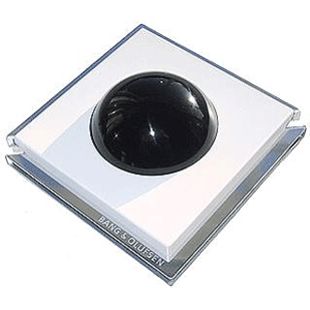

Each light which should be included in the light programming must have an LC2 unit (the latest device) attached to them. It's a small white, slim box with a dark glass 'eye' in the middle (see below). The 'eye' also operates as a tactile on/off switch - by touching it the light turns on or off; by keeping a finger on it the light dims upwards and downwards gradually.

A completely new style for the light control and a very much improved design compared with the LC1. The new shape allowed for its placement in line with the wire of a pendant fitting and easier wall mounting (see below). Installation was also much easier than the LC1, which had rather fiddly terminals in a confined space. Instead, LC2 had plenty of room and the connections were accessible and clearly marked. The touch field was retained, but was now part of the infra-red receiver dome and offered the extra function of dimming the light if it was held.
