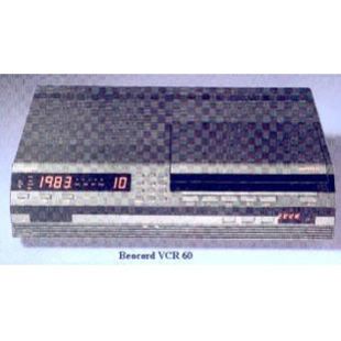

BeoCord VCR60 V2000 VCR
Manufactured: 1983 - 1985
Colours:
The next stage in B&O's foray into the V2000 technology, this machine was based on a Grundig machine and was not sold in the UK.
