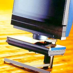

BeoCord VX7000 VHS VCR
Manufactured: 1993 - 1997
Designer: David Lewis
Colours:
Beocord VX7000 video cassette recorder was operated and programmed with the Beo4 remote control (although could equally, if not be better controlled, through the previous two-way Beolink 5000 remote control unit) through Beovision MX models.
All channels stored on the TV were simultaneously stored on the VX7000. In 1995 a new model was released specifically designed to operate through the Beo4 remote control unit and lost the two-way communication that had been one of its greatest selling points.
Features: hi-fi stereo VCR; NICAM/A2, PAL/NTSC converter; Beo4 remote control (1995 models onwards); black fascia; cabinet in the same colour schemes as the Beovision MX7000 plus black.
