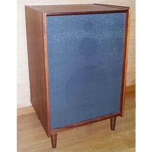

This loudspeaker offers sound reproduction of Hi-Fi calibre as a result of revolutionary pressurised construction methods.
Three speakers ensure clear definition of volume over the entire frequency range. The dimensions correspond to the calculated requirements for the best reproduction in the lower oscillation range.
_________________________
Type K Passive Loudspeakers Product Specifications
A special system of three speakers with especially carefully suspended membranes: 1 treble - 1 medium - 1 bass
Transitional Frequency: 700 - 4000 c/s
Dimensions:
Height: 77,4cm, width: 45cm, depth: 37,4cm
Membrane - 28cm, 10cm, 5cm
Oscillator Coil: 3,5cm, 2,5cm, 1,27cm
Frequency Range: 30 - 20,000 c/s; 45 - 16,000 +/-3 dB
Resonance of the cabinet: 60 c/s
Power Capacity: 18 W constant, 25 W peak
It is a rockwool-lined enclosure, without peak resonance and with special pressurisation
Impedance: 3.5 - 5 ohms
Weight: 23kg
