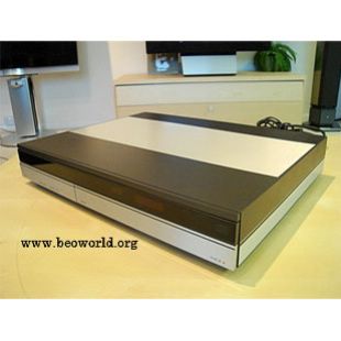

BeoGram CD50 Compact Disc Player
Manufactured: 1985 - 1986
Designer: Jacob Jensen
Colours: Aluminium, Black
Beogram CD 50 was Bang & Olufsen's very first CD player designed to be part of a stacking system and first featured in the 1983/84 product catalogue and allowed Beosystem 5000 owners to use all the buttons on the Master Control Panel 5000. Beogram CD 50 was a front-loading CD player.
The disc was placed in the motorised drawer which opened at a touch and closed either by light finger-tip pressure or by operating the PLAY control. If the disc was inserted incorrectly (upside down as compared to most other CD players of the time) the drawer opened automatically to allow the user to replace it.
Although the CD50 is quite limited in operation from the front panel as a stand-alone unit, it is a very nice sounding and very functional machine utilising Burr-Brown decoders and a large array of RAM buffering. RCA outputs are available as well as the traditional DIN connection.
Since Beogram CD 50 was designed as a component of Beosystem 5000, it had a Datalink connection to allow remote control of all functions via the Beomaster's Master Control Panel. Two phono output sockets and a 7-pin Datalink connection were provided for this purpose. However, since it was the only CD player in the B&O range in 1984, it was chosen for use with other Beosystems. An optional remote keypad - Terminal CD 50 - that could transmit commands to an infra-red sensor on the Beogram's display fascia was provided to allow remote control of the unit when not used with Beosystem 5000. The optional Terminal was also recommended for those wishing to combine Beogram CD 50 with non-Bang & Olufsen hi-fi systems.
Strengths: the laser device is very beefy with plenty of heat sinking. Lots of shielding and grounding. Burr-Brown IC decoders utilised.
Weaknesses: without the remote control the unit will only carry out a few operations from the front panel: Open, Close, Display options, Play, Skip to selection, and Standby/Off. The CD must be inserted upside down as in some older Pioneer-type CD players.
The SCAN function was a feature unique to Beogram CD 50. You could sample the first 12 seconds of each track and either reject it from your programme or STORE its location for inclusion in a later playing sequence. A comprehensive display capability meant that you always knew what was happening, what CD track was playing or due to be played, elapsed and remaining time of each track, and so on.
