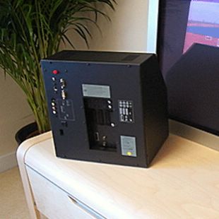

BeoSystem 2 Dedicated AV Processor
Manufactured: 2004 - present
Designer: David Lewis
Colours:
This was the Audio Visual processor designed for use with the Beovision 4. It contained all the connections necessary to make it the hub of an integrated Beolink system.
