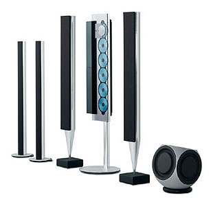

The active speaker approach - combined with innovative engineering - leads to a loudspeaker that is quite small in relation to its sonic output. This is extremely fortunate, since large, often 'boxy' speakers are often very unwelcome in a tastefully decorated room. BeoLab 8000 and BeoLab 6000 (among every other active speaker in the Bang & Olufsen range) are exemplary results of the Bang & Olufsen approach. Both speakers - with their highly polished aluminium surfaces and matching front covers - integrate into any room setting with utmost style.
