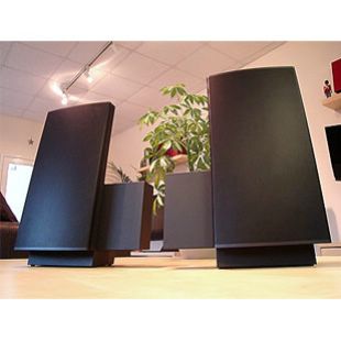

BeoLab 2500 Active Loudspeakers
Manufactured: 1991 - 2004
Designer: David Lewis
Colours: Black, Blue, Silver, Green, Red, Yellow
BeoLab 2500 are active loudspeakers designed to match the BeoSound Ouverture and the BeoSound 3000. With their built-in amplifiers, they sound as if they're three times their size. Hang them on the wall or place them on bookshelves.
They match both the Beocenter Ouverture and 3000 (previous to this they were used with both the BeoSound 2300 and 2500 music systems) with perspective and clarity, despite their modest dimensions. The explanation of the wide sound lies in the built-in amplifiers in each cabinet: one for bass and one for treble, so that they never have to compete for the same amplifier.
Features:
BeoLab 2500 are active loudspeakers with 2 built-in power amplifier modules to combine with the current (2002) BeoSound 3000 and BeoSound Ouverture. As speakers for the BeoSound 2300 and 2500 music systems, they were available in Blue Lapis, Black Granite, Red Garnet, Green Malachite, Yellow Dolomite and Silver Galena. However, new metal frets were introduced at the end of 2001. From the previous replaceable cloth fronts, they are now manufactured in pearlescent aluminium (see below). These new perforated metal frets presently come in 5 different colours - natural aluminium, black, blue, green and russet to match those of BeoSound 1."When it comes to sound reproduction we believe there's only one relevant parameter: How close can we come to the originally recorded sound. We feel an obligation not to disturb the intentions of the artist by adding unnatural elements to the acoustic image. Therefore all Bang & Olufsen loudspeakers share the same goal. They differ in size and shape and in terms of sound pressure level. But they are all developed to reproduce the natural, unaltered sound as closely as possible " - Bang & Olufsen catalogue 2001 - 2002
