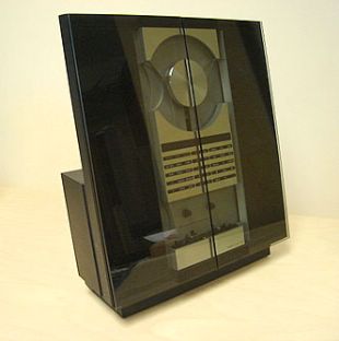

BeoCenter 2500
Manufactured: 1991 - 1994
Designer: David Lewis
Colours: Aluminium
Beocenter 2500, or Beosystem 2500 as it was called when used with BeoLab 2500 active speakers, was developed from the idea of a flexible music system that could compete with the sound quality of heavy music systems. Thanks to the advent of active speakers, this was a possibility with both Beocenter 2500 and its CD-only capable Beocenter 2300. With active speakers, each of the powerful bass and treble units were equipped with their own separate amplifiers. In addition, the electronic cross-over network ensured full bass reproduction.
The loudspeakers were located on both sides of a centre console, where two clear glass covers automatically glided to the side when a hand was passed in front of them. Behind the glass covers there was access to the operating panel, receiver, CD player and a cassette recorder.
The receiver allowed the option of presetting 2 x 20 FM/AM radio stations. The cassette recorder featured Auto Reverse, Automatic Recording level, search function and Bang & Olufsen's HX-PRO recording system, a system which ensures that the sensitive treble range is captured in recording. The memory in Beocenter 2300's CD player allowed you to edit up to 100 CDs.
Both systems could be operated via their operating panel or a Beolink 1000 or Beolink 5000 remote control. There were sockets for headphones and connection to additional sound sources; extra loudspeakers can also be connected.
Beocenter 2500 was available with loudspeaker panels in cobalt grey, black, white, cerise or jade. It was later known as BeoSound Ouverture and could be made up to the Beosystem 2500 when incorporated with the BeoLab 2500 active loudspeakers.
