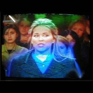

Cathode ray tubes (CRTs) - the glass tube that you look at when watching TV - have magnetic properties which must be properly aligned with Earth's magnetic fields. If a TV is moved while turned on, colour spots may appear and adversely affect the colour and picture (as shown on the picture).

Colour TVs have an automatic degaussing (demagnetising) circuit built-in. But it produces a weak field and may take a couple of days for it to go away. A simple method of ridding the screen from these unwanted blemishes is to isolate the TV from the mains for 30 minutes or so and then plugging the set back in and switching it on. This demagnetising function often causes a brief buzzing sound. Alternatively, place a compass on top of the cabinet, its needle will twitch violently when the degauss circuit is doing its stuff. Never turn the set round while it's running; the Earth's magnetic field will upset beam-landing and purity.
If this does not work, it may be necessary to contact a service company to manually degauss your TV. In some cases a purity alignment may be needed, especially if the TV has been subjected to a fall or has been handled roughly. This is when all three colour guns of a picture tube are aligned to the 3 primary colours: red, green and blue. Using a special video generator, a service technician can select and display a picture with just one gun on.

If the degauss action takes place but there's still a colour-stain, it's possible that some local magnetic field is present. Move any speakers at least 2m from the set and degauss once more. If you live in a block of flats or other steel-framed building it may be that the structure itself is magnetic! Test for this by putting the set in the middle of the room, degaussing and trying once more. It may be possible (talk to the dealer) to get the steel joists demagnetised.
In rare cases, an internal component of the CRT called the 'shadow mask' can detach and cause this problem. When this occurs, on most occasions the TV set has been subjected to a fall or heavy blow to the cabinet.
