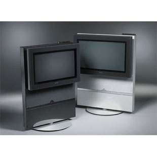

The first widescreen Bang & Olufsen TV was the BeoVision Avant, released in 1996.
It has been followed by many other models - BeoVision 3, BeoVisions 4 & 5, the BeoVision 6 & 7, BeoCenter 6, and most recently, the striking 50" BeoVision 9. However, many Bang & Olufsen owners still use the MX range, which incorporates a 4:3 aspect screen.
