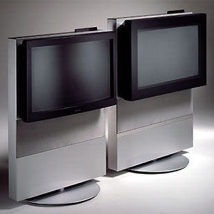

BeoVision Avant 32 VCR
Manufactured: 1995 - 2006
Designer: David Lewis
Colours: Black/Silver//Blue/Red/Green
TV isn't just something you watch, it's something you experience. That's why BeoVision Avant makes a big deal about giving you the best in audio-visual entertainment. The BeoVision Avant was created as a video system, but during its design, the idea came up of making the television a picture on the wall. This has been achieved by deceiving the eye: this is a familiar ploy in the very best of designs.
The BeoVision Avant gives you a television that acts like a picture on the wall: a wall you personally position in the room. It has a built-in video which is invisible to the viewer. Everything is operated via the Beo4 remote control. You have full control from the best seat in the living room, and the television turns towards the viewer using the motorised base.
BeoVision Avant - designed by David Lewis - was a totally new concept from Bang & Olufsen and was introduced in 1995. This video system is completely integrated holding a widescreen television, a hi-fi stereo VCR and a couple of active speakers in its attractive-looking cabinet. It was also the first wide-screen TV from Bang & Olufsen ever. Although by the end of the twentieth-century widescreen TVs were taking more and more market share, most TVs still used the 4:3 format. When Bang & Olufsen started planning for this model they originally envisaged to use the same technology then currently used in the MX series but along the way they decided to develop a completely new chassis. This new chassis is much more advanced.
The Avant is also a very environment-friendly TV using a lot of recycled material as well being recyclable itself at the end of its serviceable life. The set can also be expanded with several add-ons. For example: picture-in-picture (PIP), satellite receiver and Dolby Pro-Logic or Dolby Digital decoder. The Avant is the pathway to the future of video systems; a whole new concept of the most advanced video system from Bang & Olufsen to date.
The widescreen format 16:9 picture tube is used for the first time in the BeoVision Avant. This created conflict between designer David Lewis and Bang & Olufsen's technicians, as the designer could not see the point of it. A new picture tube that could not be filled by the TV picture. Where randomly placed grey stripes on the picture tube were a part of the framing of the picture most of the time. The technicians did not think it could be their fault. Wide format 16:9 was an attempt to consolidate a whole industry around a new market standard. The designer's talk of trimming and stretching the picture to fill out the frame was, in their eyes, simply distortion. There was no ideal solution to the dilemma.
Together they had to find the solution that would work best in practice. It was not possible to fill the 16:9 format with a 4:3 TV picture. The necessary trimming and stretching annoyed the eye too much. On the other hand, wide format had a lower limit. In the eyes of designer David Lewis, that lower limit lay in the 14:9 format. The technicians struggled to implement the format with as little distortion as possible. They also checked to see whether designer David Lewis would notice the difference if the format was a little bit smaller. Just a few millimetres smaller on the longer element! But David Lewis saw it straight away. There was a distinct limit in the eye's perception of the transition to wide format, and it lay at 14:9.
Finally, they managed to come up with a method that could handle the problem satisfactorily in practice. A method that has subsequently been further developed to implement the 15:9 format that is close to the aesthetic ideal: the golden rectangle. Programmes recorded and distributed in 16:9 are the ideal way of filling the wide format, but the range is still limited. Bang & Olufsen's wide-format TV offers a practical solution to filling the screen with ordinary TV and video programmes. It was created by trained eyes.

Its standard features were: VisionClear Technology and multi-format picture. It houses a 16:9 widescreen television with automatic picture adaptation, which means that every broadcast, no matter where it originates, is automatically shown with the optimum reproduction, from news reports in standard format, to movies in widescreen.
BeoVision Avant features the same functions as Beosystem AV 9000. When you turn it on, first it turns on its motorised stand toward your favourite watching-place. Then comes the sound, produced by four active loudspeakers hidden directly underneath the widescreen, while behind the black curtain the picture adapts to its format and to the lighting conditions in the room, before the curtains glide aside and reveal a perfect picture.
BeoVision Avant encourages you to lose yourself in a sound and picture experience - and not in the technology. That's why we hang the 16:9 Real Flat wide-screen on its own smooth wall and conceal everything else behind it - including a set of speakers that will outpace the average hi-fi and a video recorder that tunes itself automatically.
You can choose a built-in DVD player or video tape recorder and from a range of five colours. There's also the option of a simplified 66cm version with no integrated entertainment source.

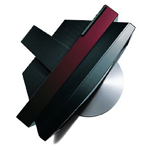

Design
Close your eyes and imagine the perfect TV. Open them again and take a look at BeoVision Avant. It's a widescreen TV that's easy to understand, effortless to use and always a pleasure to watch.
Though a widescreen TV is never going to be small in size, it doesn't mean that it has to dominate its surroundings. The Avant has a subtle presence and comes in a range of colours that allow it to compliment any environment in which it's placed.
At Bang & Olufsen, it is taken for granted that when you watch TV, you want to concentrate on the experience rather than on the technology. That's why the Real Flat screen is 'hung' on its own "wall" with everything else concealed behind.

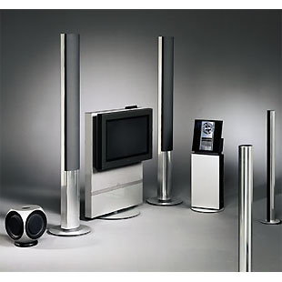

Home Cinema
There was a time when watching a movie on TV was a poor imitation of the real thing. But not anymore! BeoVision Avant brings the movies directly into your living room with a smooth, true-to-life picture and totally convincing sound.
BeoLab 2 completes this ultimate surround setup and - together with the other four active loudspeakers - allows you to make the most out of the advanced sound opportunities offered by the Avant's built-in Dolby® Digital* module.

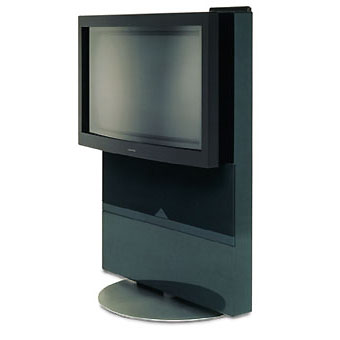

Colours
BeoVision Avant comes as one integrated unit. All you have to do is to plug in the mains and the antenna and you're ready to watch. There are no other visible cords, allowing the Avant to be viewed from all sides - so it does not have to be set up in a corner or next to a wall. It fits nicely into any kind on home, thanks to the range of many available cabinet colours: pearly blue, pearly black, pearly red, pearly green and silver.
When the system is turned off, it turns back to its original position, the sound fades away and the curtains glide in front of the screen. Just like being in your own private small-screen cinema!
