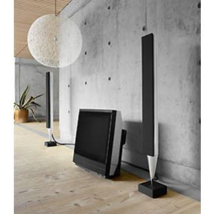

BeoVision MX8000 is a 66cm (viewable screen) television and was introduced in October 2002 as a replacement for BeoVision MX6000 and MX7000.
Based around the BeoVision 1 chassis, BeoVision MX8000 is brought up-to-date with the following options: Master Link (either as Master or Slave), RF Modulator (if used as Beolink® master), Set-Top Box Controller (with full on-screen graphics), Anti-Reflex coated contrast screen and Dolby Digital Surround Sound (including DTS). A camcorder connection is placed below the screen where the manual control on previous MX televisions was situated.

In 2002, important dialogue emerges from the powerful active loudspeakers which, following the original MX design, are sill located directly below the screen. Thanks to Bang & Olufsen’s active loudspeaker technologies, BeoVision MX 8000 delivers a sound pressure level capable of equalling many hi-fi systems. Multi-channel sound experiences covered too, as the build-in multi-channel digital surround sound module allows the connection of several external BeoLab loudspeakers, such as the BeoLab 8000 or BeoLab 6000. Big bass effects remind you of a trip to the cinema once you’ve connected a BeoLab 2 subwoofer, an 850-watt low-frequency producer to highlight the thrills and spills of a large-screen auditorium.

There are three placement options - a stand (with optional shelf for DVD 1 or Beocord V8000 - as in above picture), a motorised floor stand and a motorised base. It also has its own in-built stand to tilt back the set (as in BeoVision MX4000/4002).
