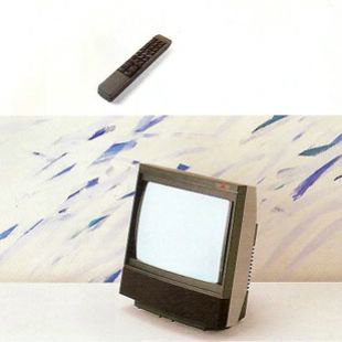

Beovision M20: the forerunner of Beovision MX2000
"The device appears as a well-formed cabinet from the front. From the rear, the encapsulation of the picture tube is so well done that the device may be enjoyed from all angles. The stacked-build of the device makes it possible to place it in a corner. Technically it contains many new functions, including the integration of a contrast screen that reduces disturbances from incoming light."
So wrote The Danish Design Council when presenting their 1986 ID prize for exceptional design to David Lewis and Bang & Olufsen for the Beovision MX 2000[/H]. Launched in season 1984/85 as Beovision M20, the basic conceptual elements of the Beovision MX exist virtually unchanged into the 21st century, with 2002's release of Beovision MX8000.
"Beovision MX2000 gives the impression of lightness and extended freedom of positioning. Now, all of a sudden, the TV could be positioned anywhere - even in the middle of a room"
The MX concept began as Beovision M20 in a modest grey cabinet and without a contrast screen. It sort of heralded what a monitor television by Bang & Olufsen might look like. Basically, a monitor is just a screen with a box around it. In the mid-1980s, the emphasis was on the picture and efforts to achieve a monitor look. The clean screen. Bang & Olufsen elected to make the television slim by placing the loudspeakers below the screen. This broke with the practice of several decades of placing the loudspeakers at the sides of the picture tube.
The latest MX 8000 model incorporates active loudspeakers and the sound has become even better. Previously, and with its Beovision MX 7000, Bang & Olufsen introduced yet another element that, so far, is unique to he company: a motorised base. Now the television turned to face the viewer - not vice versa.
Bang & Olufsen had a lot of difficulty explaining Bang & Olufsen's picture quality, which comprises many individual factors that have been optimised over the years. In 1985 - 86, the decision was made to combine everything that came under the term "picture quality" into a single concept - VisionClear. MX2000 was born out of the ideas for the M20 and was further equipped with VisionClear, including a contrast screen. The MX family became extremely popular and remains so (it is still being produced and sold). Designer David Lewis created a cabinet that fitted around the back of the picture tube, thereby achieving the purely psychological effect of making the picture tube appear smaller than it actually is. Beovision MX 2000 gave the impression of lightness and extended freedom of positioning. Now, all of a sudden, the TV could be positioned anywhere - even in the middle of the room.
Bang & Olufsen's first television in the the US market was a variant, Beovision MX 5000 US. But, because of sales factors and market conditions at the time, it was not a great success.
