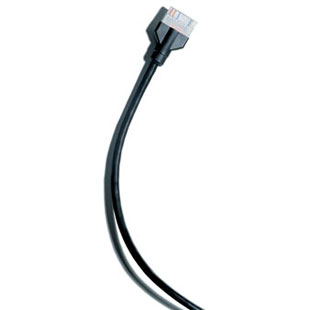

Masterlink
Master Link
1992 -
Below are descriptions of individual elements of the Master Link system together with application uses:

Beolink® Video is connected to the TV set by means of the 7-pin Datalink cable and to the main room with a Master Link cable.

Note that the AV 9000 Audio Kit with switch cannot be used with the new 9-pin Master Link cable
