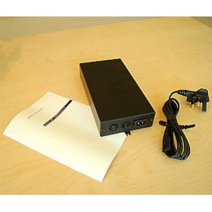

BeoLink Converter
Manufactured: 1995 - present
Designer: David Lewis
Colours:
This product allows the use of audio and video products with Audio Aux (Datalink) in a ML system.
It has a clever autoconfiguration feature which means it sets itself up depending on the connected units. Uses can be to connect an older audio set up such as a Beomaster 7000 to a newer video set up such as an Avant or a newer audio set up to an older TV.
It has a supplementary use in that it could be used with a Beocenter 2300/2500 which were fitted with MCL drivers to power an ML system. This requires the Converter to be of the newer type : 1161166. the older 1161466 is unable to perform this function.

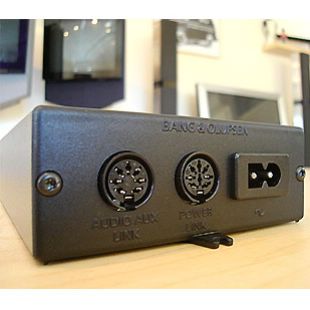

BeoLink Converter Product Specifications
For connection between ML and AAL audio and video products.
Link room product
Operation
Remote operation Beolink 1000 one-way
(Throug connected products) Beo4 one-way
Beolink 5000 two-wy (only AV 9000 Audio kit)
Campatibility Beosystem AV 9000
All A/V masters with Master Link distribution
All video masters with Master Link distribution
Cabinet Black aluminium/plastic
Placement Fastened to the wall
System data
Frequency response 20 - 20,000 Hz +0/-1 dB
Signal-to-noise ratio > 82 dB
Dimensions W x H x D 20 x 10.5 x 4 cm
Power consumption, operation 2.1 watts (230 V AC)
Power consumption, stand-by < 1.5 watts (230 V AC)
Weight 0.6 kg
