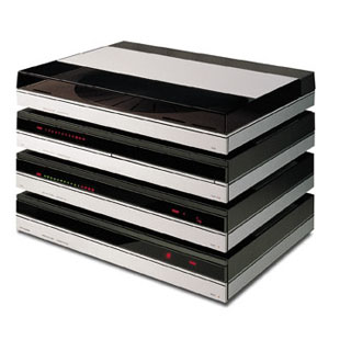

Datalink first was seen in its full glory in the BeoLab 8000 system in 1981. Unlike the earlier system, full remote control of all the different sources was now possible, with play, record, cueing, programme selection and volume control all possible at the press of a single button on an infra red remote control. The system also allowed one to press a start button on any of the sources which would switch on the Beomaster or vice versa. All the sources were attached to the Beomaster by 7-pin DIN leads. An important point was that the Beomaster remained the hub of the system with all commands from the remote control travelling via the infra red receiver on the Beomaster and Datalink being the messenger to the source.
The system was refined over the years and eventually allowed all functions to be controlled remotely as seen in the Beosystem 7000. These days, the system has fallen into disuse but the language continues in a different guise as MasterLink. No longer speaking between components in a single audio system, MasterLink connects systems together. Older systems can still communicate with the aid of the 1611 converter which translates Datalink to the newer codes.
