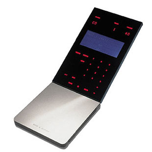

Imagine a remote-control which spoke back to you. Imagine a remote-control which confirmed that your commands had been carried out. Imagine a remote-control that gave you visual feedback of your instructions and reconfirmed these every time you pressed a button on your Bang & Olufsen Beolink 5000 or Beolink 7000.
This interactive remote-control system was around from 1985 to the mid-1990s when two-way communication was in use in the majority of Bang & Olufsen's audio and video products.
The first product to use two-way communication was in the innovative Beosystem 5000, designed by Jacob Jensen. Its remote control terminal - Master Control Panel 5000 (MCP5000) - was used for instructing Beomaster 5000 to follow out your commands, and in turn, Beomaster 5000 confirmed your instructions by instantly sending signals back to your MCP5000 so that you could see that they had been carried out. Further, by using Bang & Olufsen's Master Control Link (MCL) around the house in a Beolink® system, the Panel could enact your instructions and confirm that they had been initiated through the Beolink® two-way MCL wall sensor.
Two-way communication progressed throughout the 1980s with Beosystems 5500, 6500 and 7000 when the one-way remote control - Beolink 1000 - was introduced to complement the other terminals in the family. However, it was necessary to use either Beolink 5000 or the more sophisticated Beolink 7000, to receive visual feedback of your commands, for products not equipped with their own MCPs.
So what was Two-way Communication?
Two-way operation and exchange of data: a command was issued from the Beolink 5000 or 7000 when you activated a key. The command was received by the two-way audio/video product and the processed command was relayed to the source via Datalink. A confirmation was then sent all the way back to the remote-control to update the panel.
What were its benefits?
Instant feedback of the source being played was the obvious benefit. However, programming a video recorder (such as the VX7000 with either the MX6000 or MX7000) was made so much easier if the VCR was communicating with you real-time. It was just then a simple matter of answering the timer questions and having them confirmed with you at each stage. Linked with this, if a hi-fi or video was situated a long way from you and you found it difficult to read the tracks numbers, Beolink 5000 and Beolink 7000 made it so much easier. At night, Beolink 5000 and 7000 made the task of using your remote control a lot easier. Beolink 7000 of course, illuminated the information in red LEDs; with Beolink 5000 it was just a case of hold up the transparent readout to a light source (say, a TV screen) so that you could easily make out the readout. With Beo4 of course, this is not so easy, as each time you need to use it, you either have to remember which button to press (with 'List' this is almost an impossibility) or else turn on a lamp each time you wish to use it.
