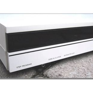

Images of White Beomaster 6500 by kind permission of Martin Olsen.
